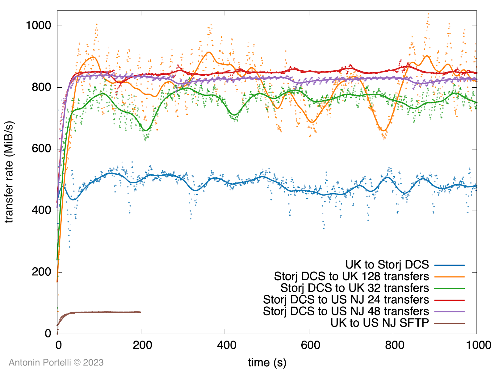

Prof. Portelli used a scientific dataset used in particle physics research with 2000 x4.7 GB binary files, for a total of 9.3TB to test Storj’s performance. The benchmark involved uploading the data set from Edinburgh to Storj, then download back to Edinburgh, download to a data center in US New Jersey, and compare with a direct SFTP transfer for a baseline.

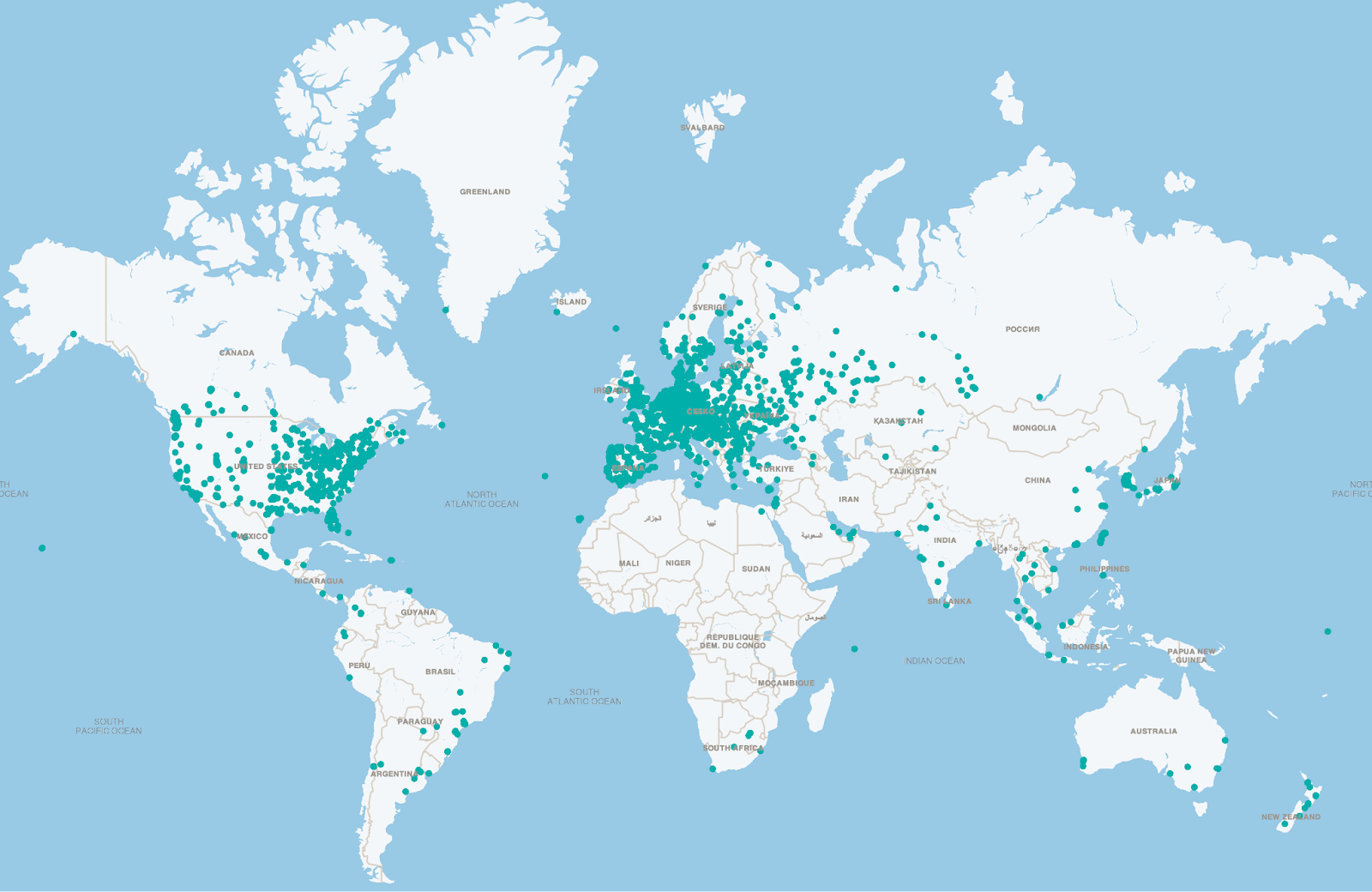

After the upload to Storj, Prof. Portelli tracked the storage node locations where the segmented files were sent to on the Storj network. The map below shows the geographic analysis of the Storj distribution.
Actual storage node locations where the data segments were distributed
Storj calls 80 segments and sends them using parallelism where the 29 fastest segments can be used to reconstitute the file being requested. The data below shows the transfer rates for downloading to Edinburgh (UK) as well as a data center in US New Jersey showing various transfer groupings.
Study from 2023 showing the Storj transfer rates of a large dataset to the US
Prof. Portelli notes there was relatively no difference between download transfer rates in the US versus UK. “What you can see is really quite remarkable that there's essentially no difference in the transfer rate between downloading the dataset in the UK and in the United States. And this is very likely thanks to this kind of really good distribution between Europe and the US we just saw on the map.” As to Prof. Portelli’s reaction to the transfer rates? “The transfer rate is around 800 megabytes per second. This is extremely fast!” Prof. Portelli also noted that the upload was 2x slower than download and expects this may be a bottleneck from the origin file system, not part of the Storj network.

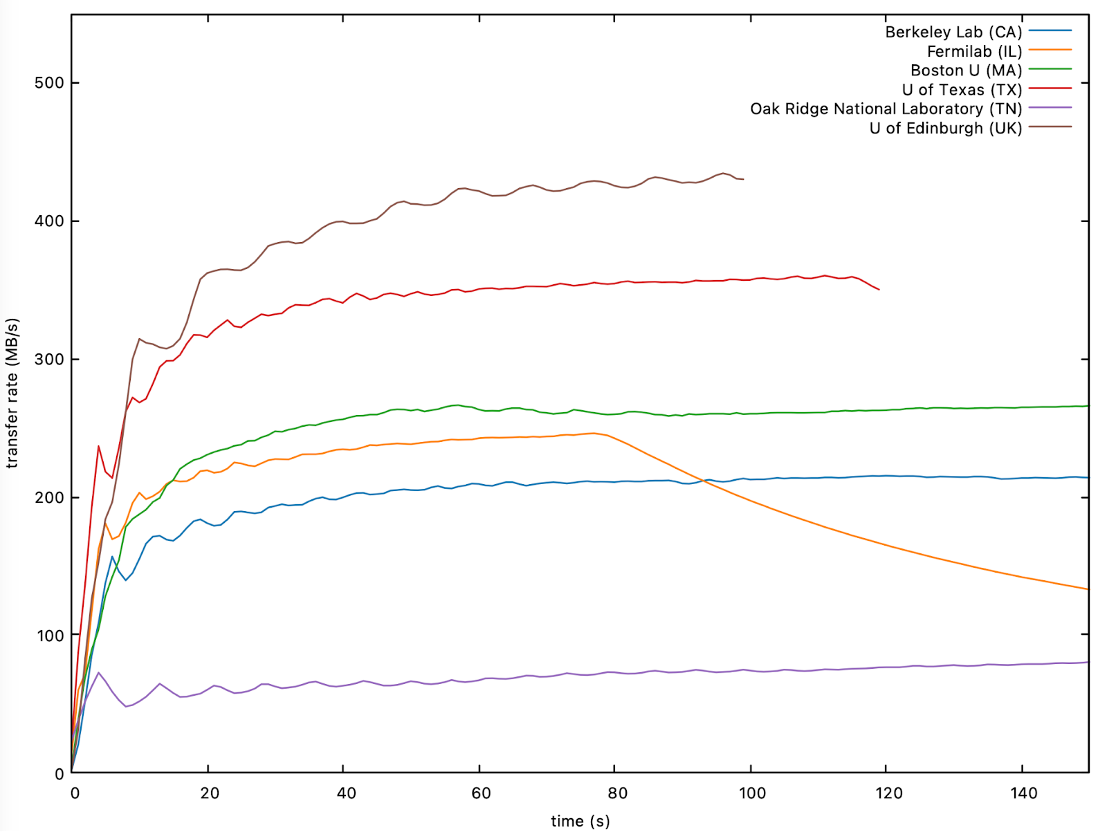

Prof. Portelli then compared these results with the testing he did two years ago and the improvement is impressive.
Study from 2021 showing the Storj transfer rates of a large dataset to the US
This data shows there has been a 2x-4x factor improvement in Storj transfer performance. Prof. Portelli summed up the results with two key takeaways:

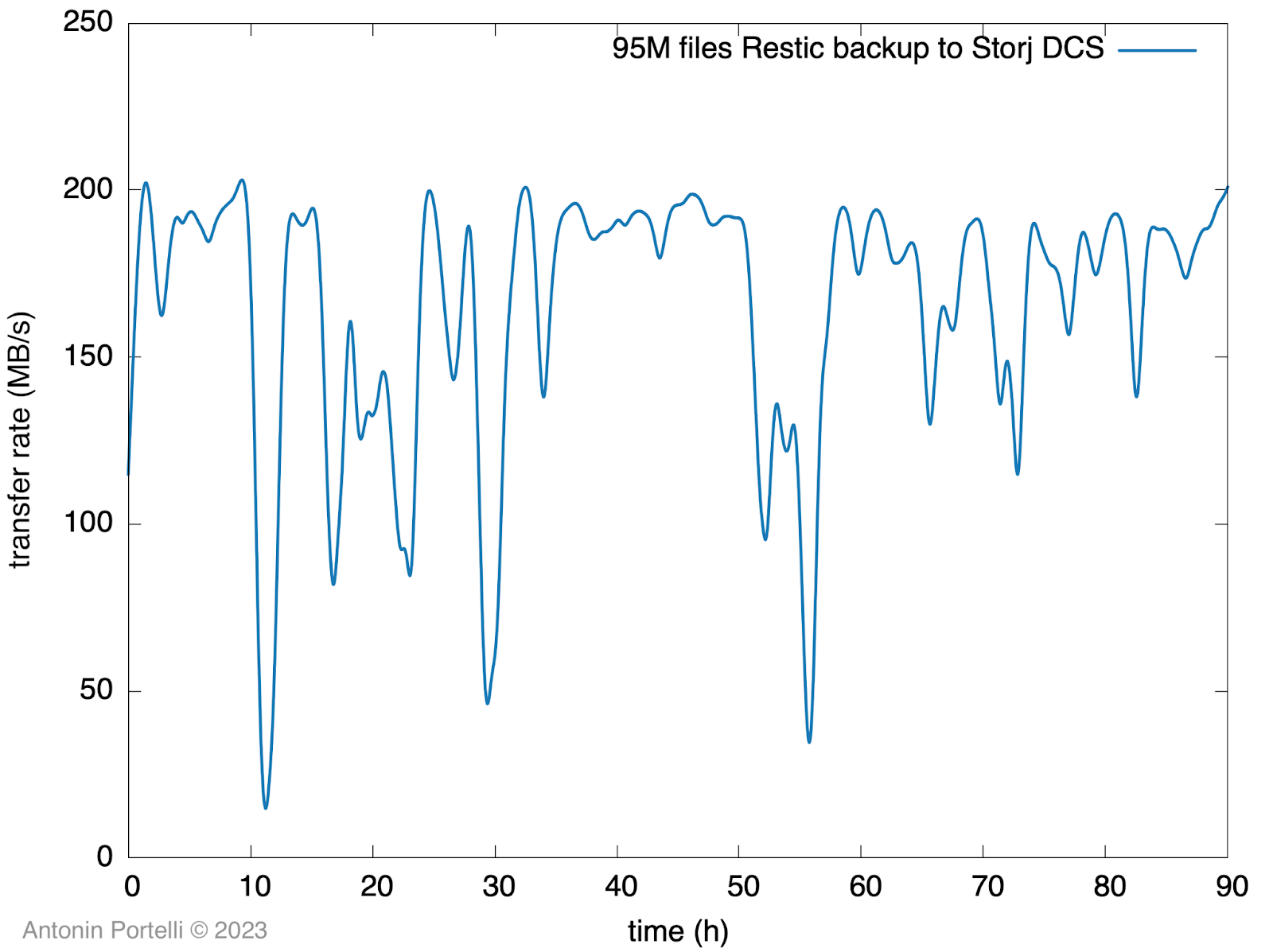

A DiRAC IBM Blue Gene Q supercomputer was decommissioned in 2016 and the file system was preserved. In total it contained 300 TB from around 95M files. The team made the decision to archive this enormous dataset to Storj. Prof. Poretelli knew this would be a challenge as it is the equivalent of “backing up an entire data center.”
Actual transfer rate for backing up a supercomputer with 300 TB to Storj
Prof. Portelli used Restic to group the smaller files together in order to reduce the 95M files into closer to 4M total. The results show that transfer rates reached 200 MB/s. While this is 4x slower than the previous test, Prof. Portelli explained that this is due to the operation Restic is doing to concatenate five 60 megabyte pieces, duplicate them, and anchor them. This is a very CPU and I/O intensive operation.”
Prof. Portelli was five days into the archival when he shared this data. He estimates the entire 300 TB will be transferred in 10-15 days. “The only thing that really matters here and interests me is that Storj plus Restic brought archiving this whole file system to a humanly acceptable time. So now we have hope.”
