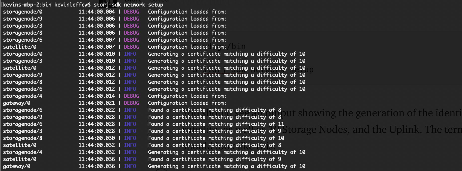

You should see an output showing the generation of the identity certifications for the Satellite, as well as 10 storage nodes, and the Uplink.
The terminal output should look like this:
As shown above, the config is generate certificates for the storage nodes. The public key of the node’s certificate authority determines its node ID (which is the hash of the public key and acts as a proof-of-work threshold).
_As shown above, the config is generate certificates for the storage nodes. The public key of the node’s certificate authority determines its node ID (which is is the hash of the public key and acts as a proof-of-work threshold)._

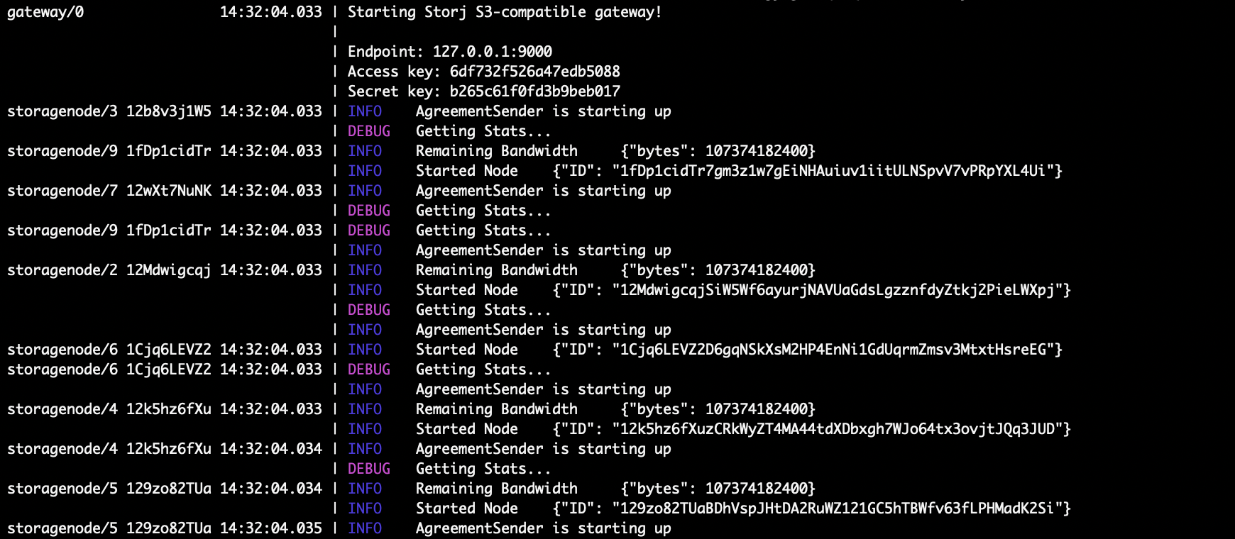

Observe the output for the gateway generation and take note of its output. You should see something similar to what is shown below:
The ‘network run’ command will boot up the satellite and ten storage nodes.
_The ‘network run’ command will boot up the satellite and ten storage nodes._

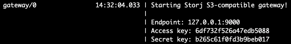

To navigate to the Minio interface, copy and paste the URL for the gateway into your browser (in this case the above output, labeled Endpoint, shows 127.0.0.1:9000)

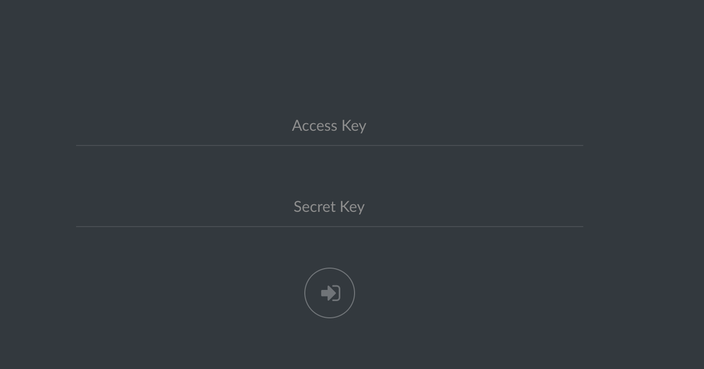

Navigating to the Minio interface will prompt a login screen, asking for the key credentials
_Navigating to the Minio interface will prompt a login screen, asking for the key credentials._

An S3 gateway was bootstrapped, and the terminal outputted a sample access andsecret key, which we used in the Minio section (see below):
Starting Storj S3-compatible gateway

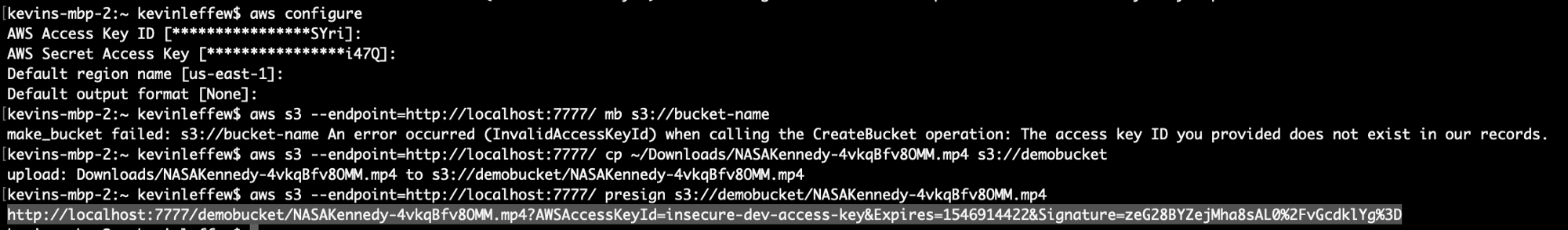

We have now successfully connected to the AWS command line. Let’s try a few commands:
$ aws s3 --endpoint=http://127.0.0.1:9000/ ls
This will show us if we have any existing buckets in the environment (if you created buckets in the GUI/Uplink sections, these will be listed).
To make a new bucket, run:
$ aws s3 --endpoint=http://127.0.0.1:9000/ mb s3://demobucket
Next, let’s upload a file to that bucket and generate a presigned URL to stream that file from the browser:
$ aws s3 --endpoint=http://127.0.0.1:9000/ cp ~/Desktop/your-large-file.mp4 s3://bucket-name
$ aws s3 --endpoint=http://127.0.0.1:9000/ presign s3://bucket-name/your-large-file.mp4
This will generate a URL and will allow live video streaming from your browser (or a VLC).
